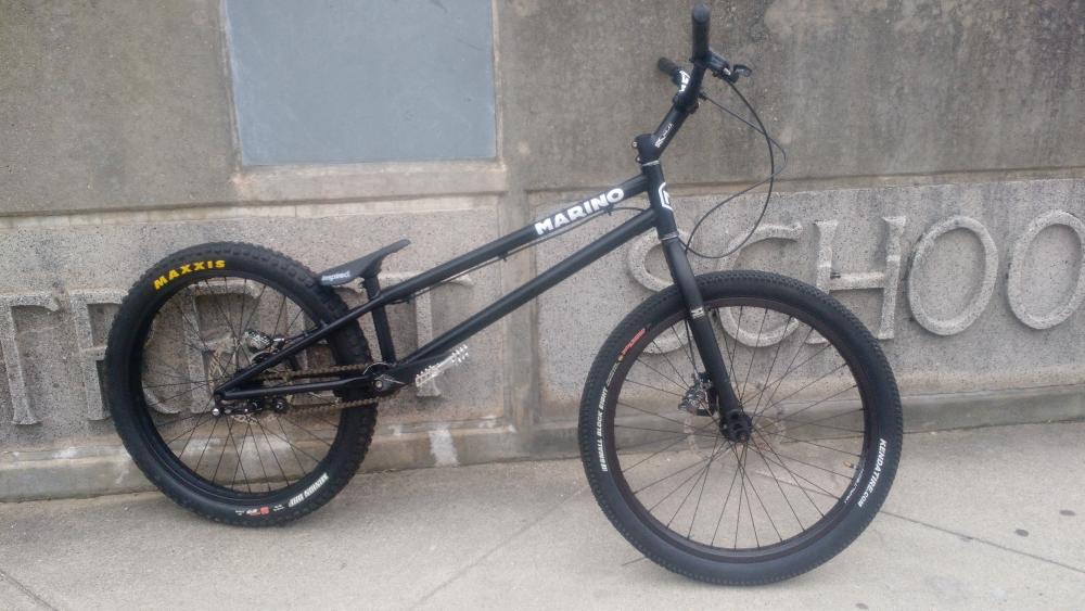

  2. Finally got my Marino in. Sadly there is no way to make the SLX cranks clear the chainstays, even with axle spacers. I had it made with a 73mm BB shell, so I can't really use BB spacers. Ugh. Looking into other options. Anybody up to buy a brand new pair of SLX cranks with basguard? lol

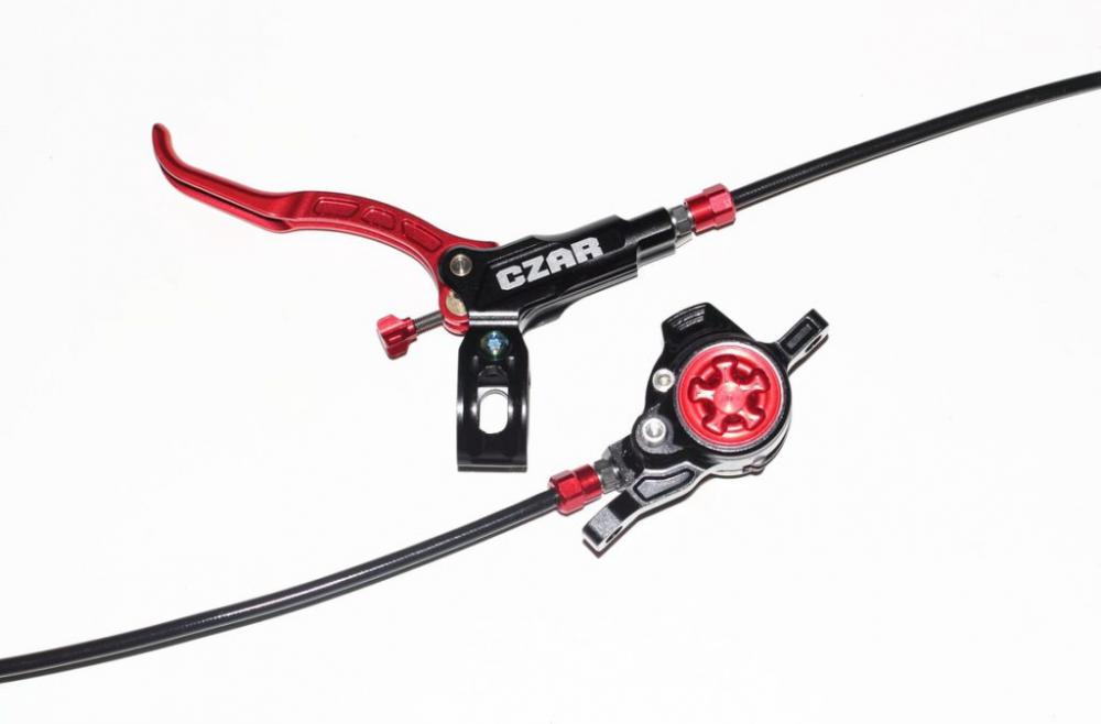

  16. So poking around the web I noticed a few things. A new Echo SL Disc brake A new "Czar" Disc brake A new 2017 Echo SL Rim brake. So as far as the rim brake goes, is there anything different with the new one besides the lever blade? (It does look more comfortable) For the Echo SL Disc and Czar disc brake. Anybody know anything about them? More power than the TR? Just curious. I had good luck with the Echo TR rim and Disc brakes before. I'm not sure how much more abuse my MT7's can take, and I'll take cheap and reliable anyday over expensive and unreliable.

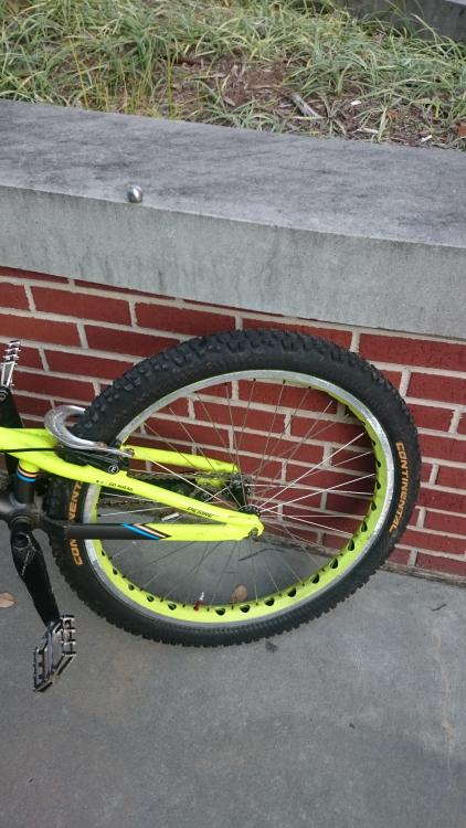

  18. I successfully converted my rear wheel on my 26" pure trials bike this weekend. Echo double wall 47mm rim For kicks I used a conti trial queen. I choose this tire because I loved the way it felt but was getting constant pinch flats. I used to have to run it at 34psi to avoid pinches. In my test I started at 29psi and dropped pressure a few times. Running just above 22 psi, which would've resulted in a pinch in a few minutes, no leaks or anything I did not use the foam strip, i really don't think it is necessary. One note for rim brakes. A bit of sealant got in my rims when sealing. It pretty much dries into wax and the brakes were not a fan. It took a few minutes of dragging the brakes to get this better, but my brakes were still not at 100%. Next time I will be more careful, grind first, and find a way to clean the rims up proper. I rode some proper sharp corner urban, but unfortunately I don't have any proper natural near me.
