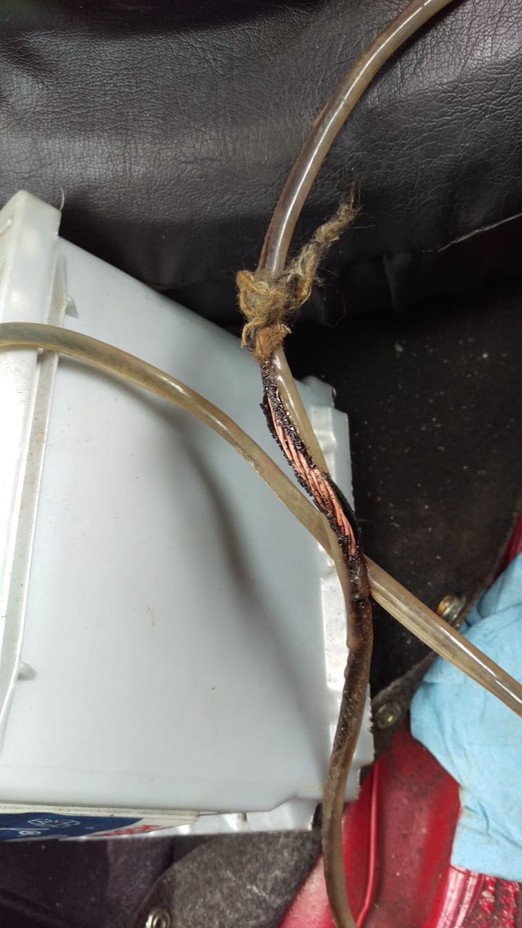

Car overheats, I turn it off to avoid damage. I can't turn it on again, I just get rapid clicking. I jump out to figure out what to do and notice shit loads of smoke. Opened the boot to find LOTS of smoke. Quickly emptied the car of all valuables, just in case.
All of this at one of the really busy junctions in Bristol, at rush hour.
Thankfully, some great people stopped and helped me, but she's currently parked up for the night.
No clue what the problem is, but it could be high resistance from crap connections.

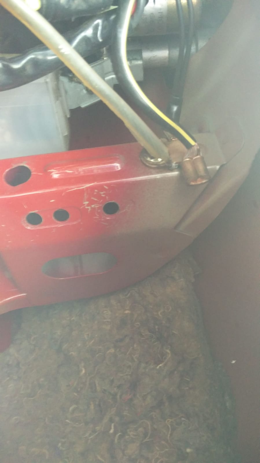

OMFG, you won't believe what the problem with my car was.
A previous owner had used tiny SPEAKER WIRE as one of the main battery cables and it totally fried it. The smoke wasn't the battery, but the wire that was about 6 inches further into the car.
It was about 1/3 of the thickness of a proper earth strap.
Unbelievable. How it hasn't caught fire before now, I don't know.
The rest looks OK.
It looks to me like the original one snapped, so they crimped in this 6" section of speaker wire. I've never needed to look down there, so haven't spotted it before. If you just looked at the battery, everything looked alright.
It's amazing that it lasted so long.
