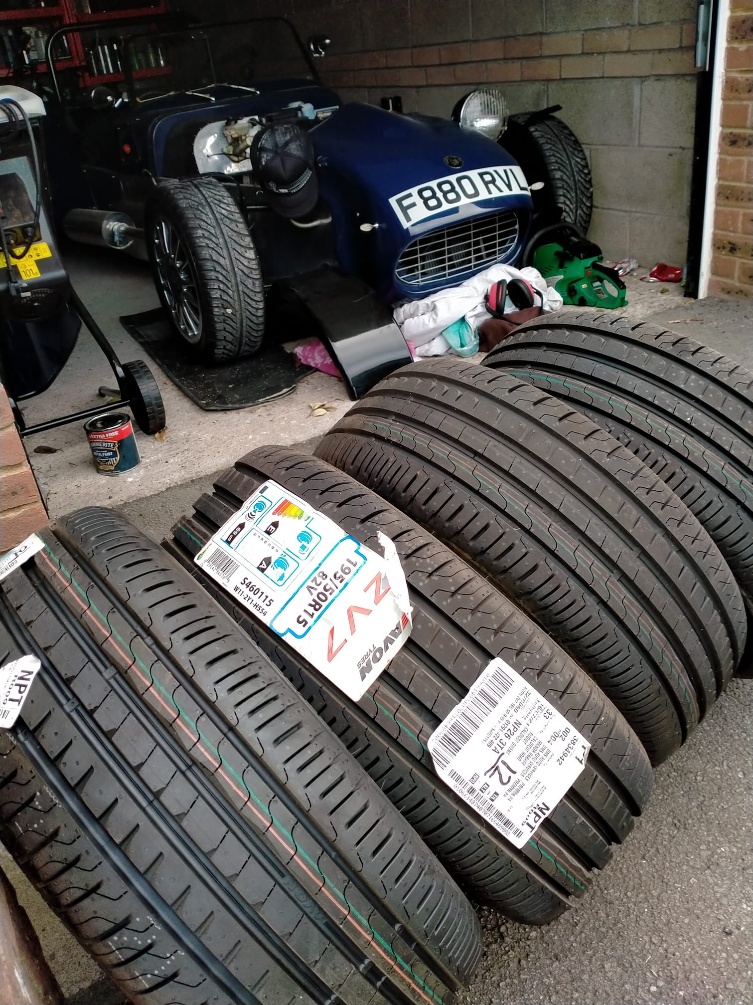

The garage that had my new tyres ready called me today, they're getting rid of their tyre bay so I had to grab them. I now have a broken car and four new tyres in the garage.
It's coming up to six weeks since I got hit, not really any closer to getting a working car. Fed up to say the least.

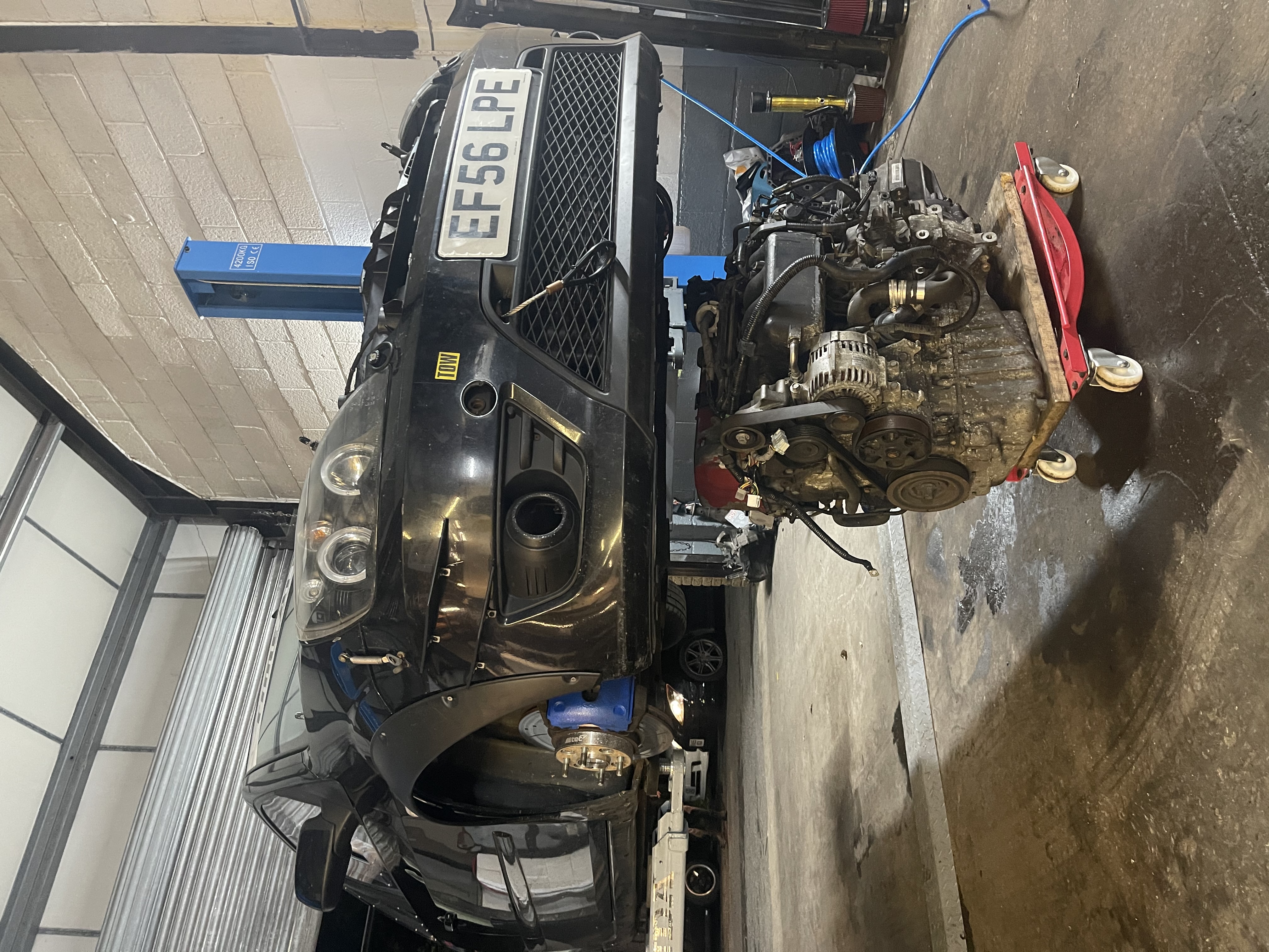

Took the banger for an mot (speculative) and it failed, but in such a way I would be stupid not to fix it and simultaneously be stupid to spend any money on fixing it. Bah. Coil spring and some dust boot on the anti roll bar. both garage jobs for me but relatively cheap, its just pretty much everything is now broken and its a ticking timebomb of a car.

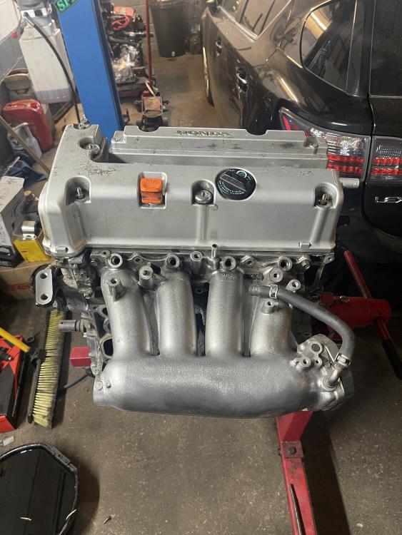

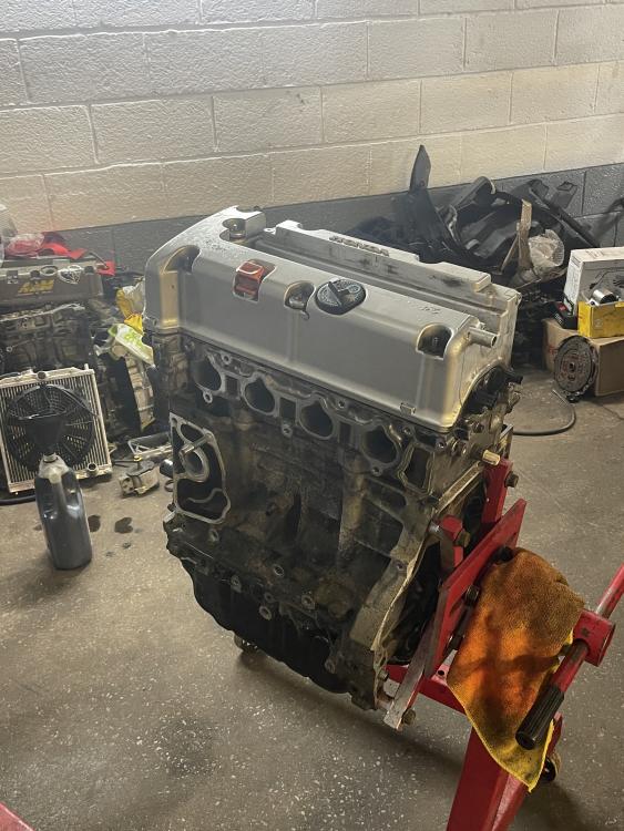

I’m reviving my old Civic Coupe.
I had a look round at what I had to hand, how much I’d realistically have to buy and at what cost to make it a viable option. I have a gearbox, driveshafts, radiator, hoses, K swap engine mounts and a suitable chassis. The engine was going to be the deciding factor.
As a result of everyone throwing K20s into just about anything these days they’re commanding more money than ever. Without spending serious money you’re looking at around 230-250bhp absolute peak too for your money.
Ive had a K24 sat in here from an accord I pulled apart a long time ago with a view to doing a K24/K20 Frankenstein build until we found his Civic shell was rotten and it was abandoned. Cue a phone call, £350 later and the engine, box, headgasket, stem seals, head bolts... LOTS of parts essential for the conversion all included. He let me have the lot.

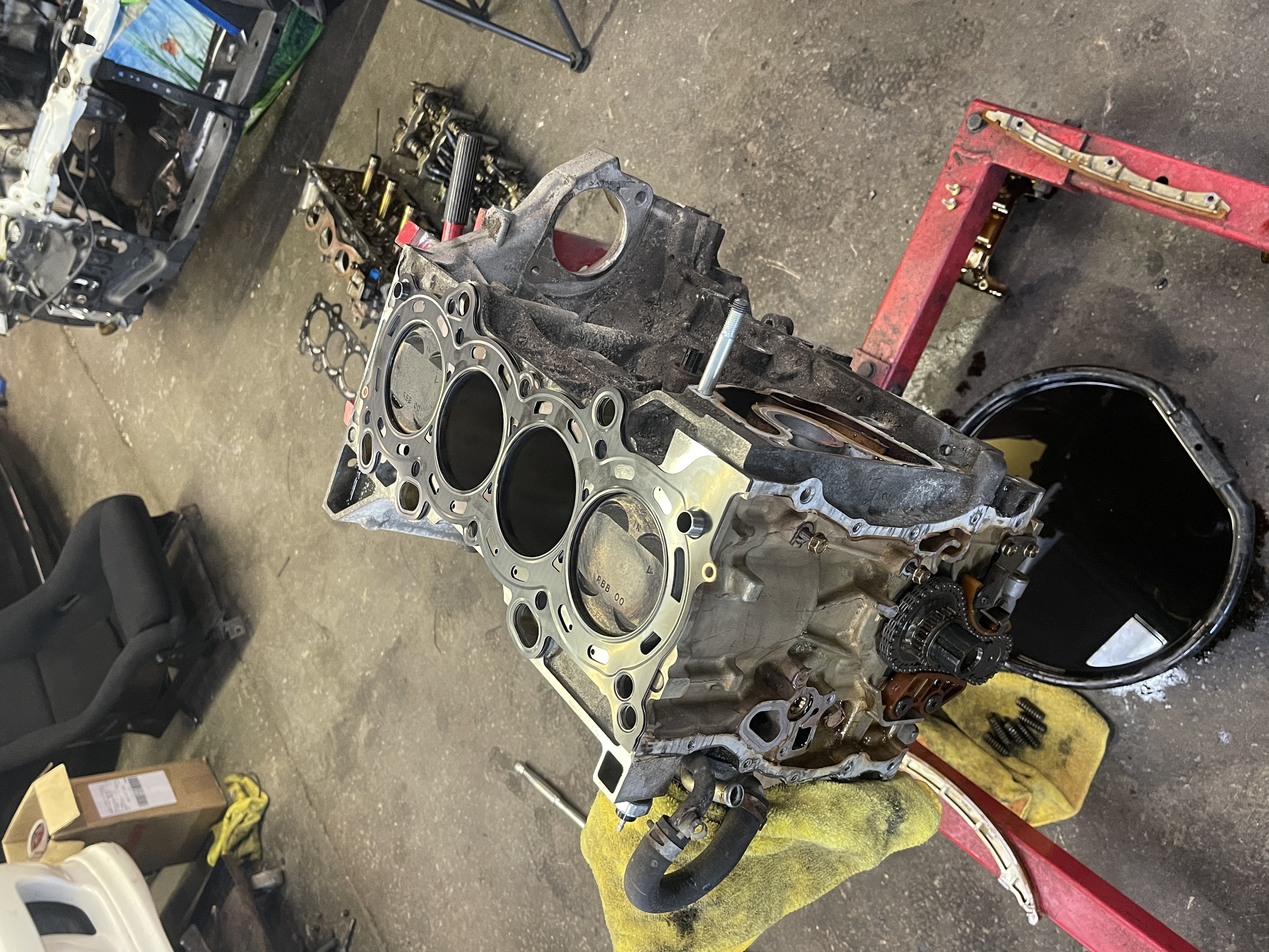

Stripped the engine down to the bottom end only. Sump off, head off, oil pump off.
The K24 uses a beefy pump incorporating a pair of balance shafts that aren’t RPM friendly. Searched the shelves and found a K20A2 pump in good order that was stripped and cleaned/inspected for wear before being modified  to fit the 24 bottom end. (Requires some material removing to clear the main/girdle bolts)

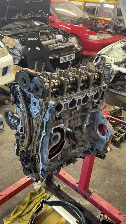

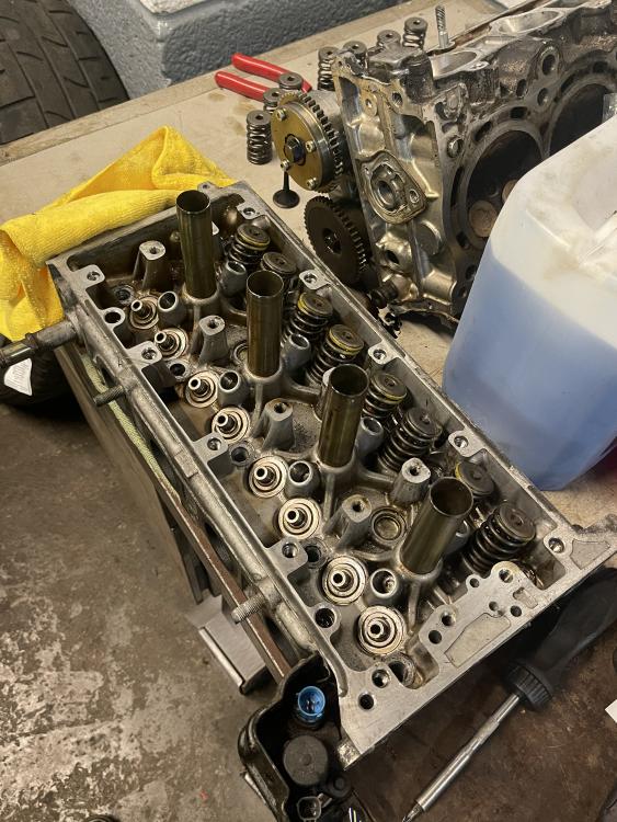

Another search through my spares and I found a K20A2 cylinder head along with the camshaft carrier/rocker assembly and a pair of camshafts with exh gear and 50deg VTC inlet gear. I had this head skimmed years ago for another engine destined for a customers engine that never went ahead. Big bonus! Replaced the valve stem seals, offered onto the block and torqued down. Bagged an RBC inlet manifold for £250.00 too.
New timing chain, all re-assembled and I have an engine that’s capable of around 250-260bhp, makes more power everywhere in the midrange and a nice little increase in torque too (at the expense of peak RPM limit due to long stroke) for £600.00. In a world where Honda parts are doing nothing but sailing through the roof I’m over the moon.

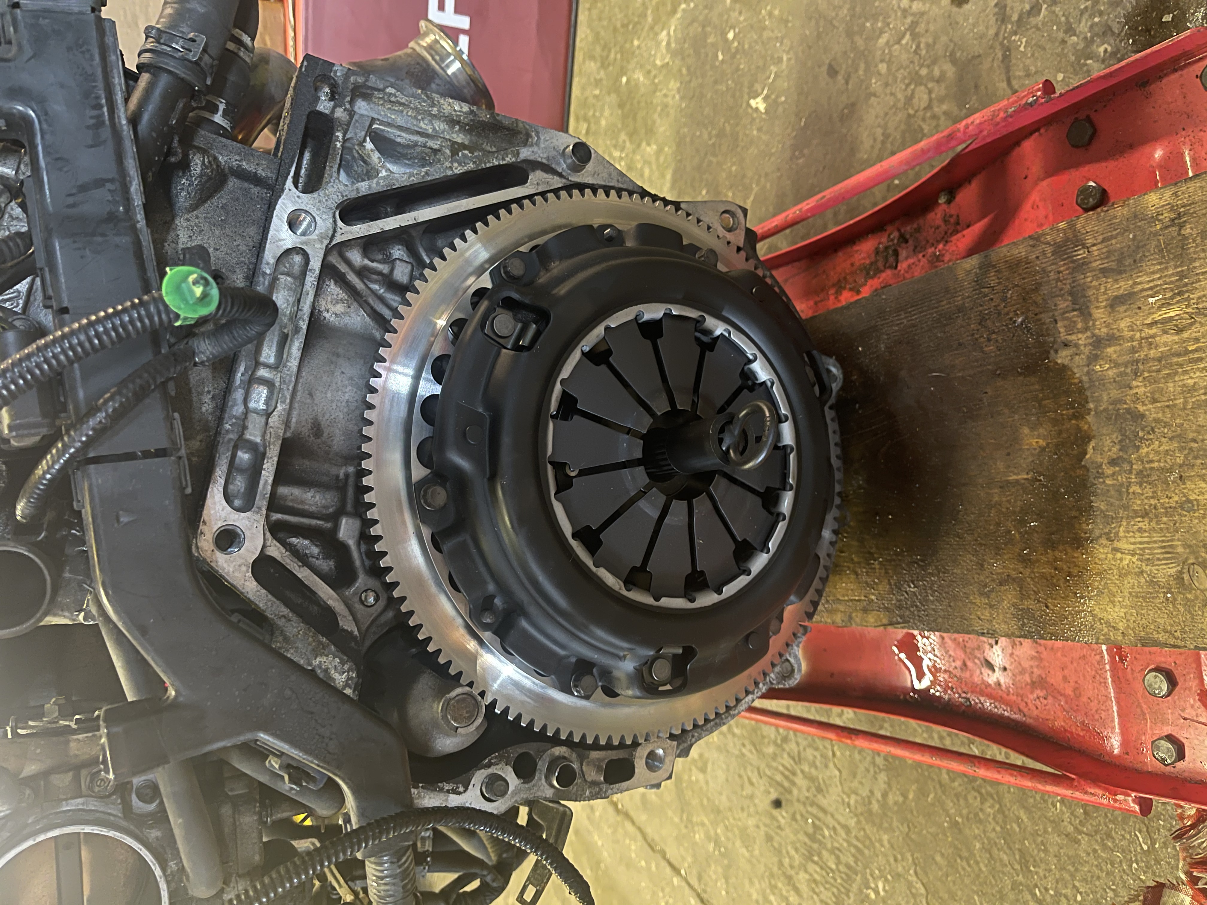

5.1 final drive, plated diff, complete bearing/seal replacement for the box, light flywheel, posh clutch and a sump baffle. With how close the water pump pulley sits to the chassis leg it doesn’t allow the lot to drop on one side enough to remove the box conventionally, so out the lot came.

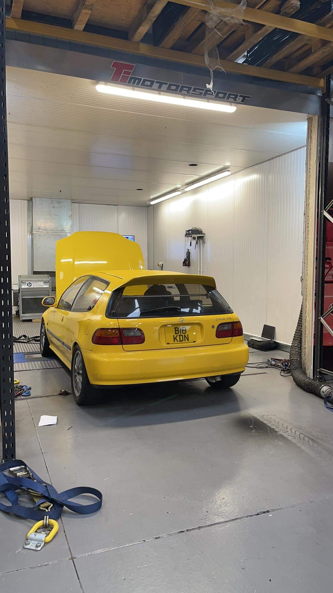

DC2 and EG6 dyno day yesterday!
Integra - K20. Was expecting a little more from it really, and I could tell that Jesse (tuner) wanted to see more too. MAP readings were indicating there’s a restriction somewhere. We picked up around 6hp changing intake tube lengths to alter resonance/frequency so there’s some improvement to be made there, and possibly a larger TB. 230bhp peak was the end result, but the midrange is far better, 16bhp increase from 5500 right through till about 8400rpm where it plateaus.
Civic - B18. Really impressed me. I’d said if it cracked 200 I’d have been impressed. It ran 203 peak on the first run, but the graph on the existing map was terrible. So peak power was in the region I’d hoped, drivability and midrange to improve. Everything seemed to work really well together, intake temps nice and low, exhaust flowing well and the engine in general being very healthy with a hugely smoother/improved midrange too.
206bhp peak to finish. Great fun
  • Like 2
