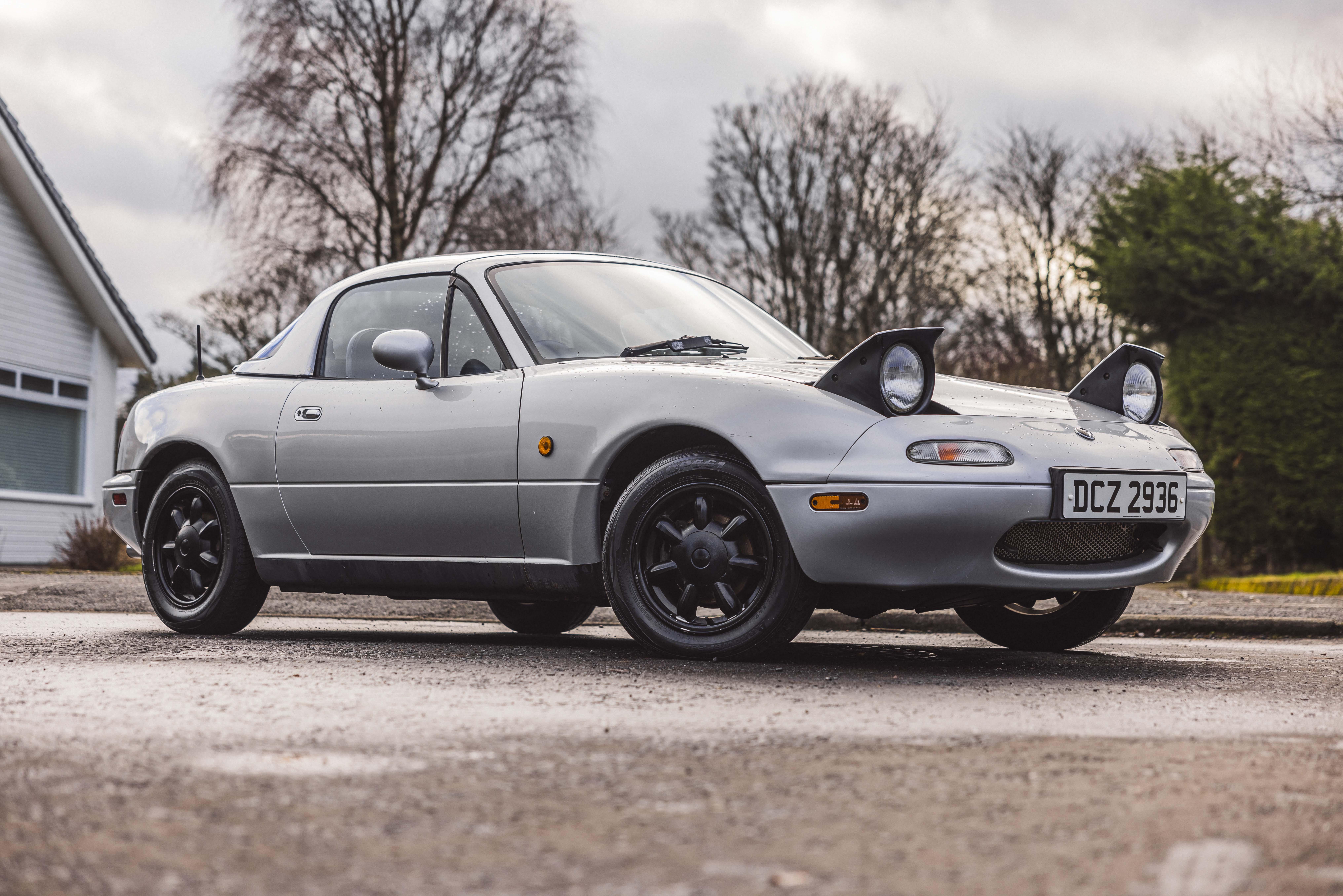

WTF happened to project Binky ? its been a hella long gap between episodes and the stanceworks guys voice is starting to annoy...
Also, as you've all owned at least 10 mx5s , what advice would you give to buying one? Asking for a friend (genuinely).
Rust. Everyone says it and it's true, they rot, badly.
It seems mk2.5's are the worst for it, but they all rust around the sills and generally underneath. The mk4 came out in 2015 and I know of one that had rust advisories on its first MOT!
From personal experience, when I buy another one, I'll check:
1) Is it rusty. If you can see rust on the sills, it's much worse than it appears, as they rust from the inside out. Usually due to blocked drain holes behind the seats. Many owners don't know about these drain holes and they fill up with leaves and crap over the years, collecting water and then rotting the sills. Ideally you want one that's been cleaned out frequently and garaged, or one that's just been properly repaired.
2) Is there blue smoke on start-up, or when driving - get someone to follow you on a test drive. I may have been unlucky, but my Eunos ended up having three different engines, all of which were 1.6's and they drank a lot of oil. The first did most of the miles, the next two were just lemons.
3) Brake calipers are prone to seizing - especially the rear, when people leave the handbrake on. Check the discs to see if they've been used lately, if they're rusty, there's a good chance the rear brakes aren't doing much. When I got mine, both rears were seized - I assumed they were just crap old brakes, but closer inspection showed I was driving with just front brakes :laugh:
4) Low mileage doesn't necessarily mean good car. See point 1. A car with 40k on can be more rusty than one with 120k on.
Things to do when you buy one: fit a roll bar, or at least a cabin brace, they make a big difference to stiffness. If standard, replace the exhaust. They're very quiet as standard and a decent manifold and exhaust system isn't mega money - if it's age appropriate, a de-cat pipe will give small performance gains too (Plus it sounds nice imo!). Adjustable coilovers make a massive difference too, though it's certainly not bad handling on the standard suspension.
Oh and if you get a mk1 with the speakers in the seats, take them out, cut circular holes in the foam and fit new round speakers - they sound much better. I can't remember the exact size to use, but a search on Google will reveal that.
All in all, you can't really beat them for smiles-per-gallon - they've relatively cheap to buy, fuel economy not too bad and just great fun. I know mine had a reputation for being unreliable, but in reality it did 260k, three Euro trips and several track days. It would still be in my garage now if the rust hadn't finished it off. Most days I consider selling the Tiger and buying another one, next summer maybe!
Having owned a Mk2.5 and a Mk1, I would say to not bother with the Mk2 or Mk2.5s. They have more creature comforts and feel more civilised, but they feel like they have no character compared to the Mk1, and just feel less 'fun'. That may be because I had the 1.6 Mk2.5 which is seemingly the slowest engine they did, with my Mk1 1.6 feeling a lot more peppy. Ads had tinkered with that engine a decent amount so it's not exactly a fair comparison, but AFAIK even the basic engine was still more powerful than the 2.5. There's just something about the cabin in the Mk1 that's a lot more charming, and ultimately you can't beat pop-up headlights. Every time I got into my Mk1 it felt special somehow, whereas with the Mk2.5 it was just... 'meh'. It was still a fun car, and it was a hell of a lot more fun than the Passat that replaced it, but it isn't a Mk1 ultimately. You make a lot of compromises when you decide to get an MX-5,s o you might as well go the whole way and get the fun one.
A cheaper upgrade to get a Mk1 sounding nicer is to change to a cone-style air filter. I did that on mine and it made a noticeable difference to the engine note when you're further up the rev range, and was sub £30 for the whole kit so not exactly pricey!
On the rust front, that is the biggest issue to watch out for. I'm super glad I sold mine when I did - it failed it's next MOT on rust-related issues, then failed the one after that on even more rust-related issues. They did a different setup for the subframe on the 2.5 compared to the 1, and basically made it so it had the opportunity to hold water between the two 'skins' of the subframe. As you can imagine, this doesn't end well.
Other notes were that the glass rear screen on the Mk2.5 was nice, but it meant that raising and lowering the roof was harder. The stitching started shitting the bed around the edge of it because as the hood material starts getting more brittle with age it doesn't handle the movement as well, especially if you've got enough tension in the roof to stop it leaking... At least on the Mk1 with the plastic rear window it just flops down. As long as you make sure that it's folded down neatly you shouldn't get any creases or f**kery.
Keeping the drain holes clear is super important. Getting one of those super long bendy little brushes is a good shout as you will need one in your toolbox. Going bottom up when you clean them is a lot easier than top down, but just be aware you're going to get a wet arm when you shift the blockages in them.
Lastly, if you lower or stance an MX-5 you ideally need to get in the sea. They ride really nicely as standard, and if you ever want to drive it fast the extra feel you get from it will make it a lot easier to get near the limit (or just know where the limits of grip are if you want to get slide-y). It'll make it a lot nicer to use as a daily too. There's someone locally who's stanced their MX-5 and it seems like a criminal waste of a fun car, they can barely get it around town. If you're into it then fair enough I guess, but there are plenty of other cars out there that are pretty shit to drive to begin with that you may as well start with rather than getting one of the best handling little cars around and turning it into a bag of dick.
