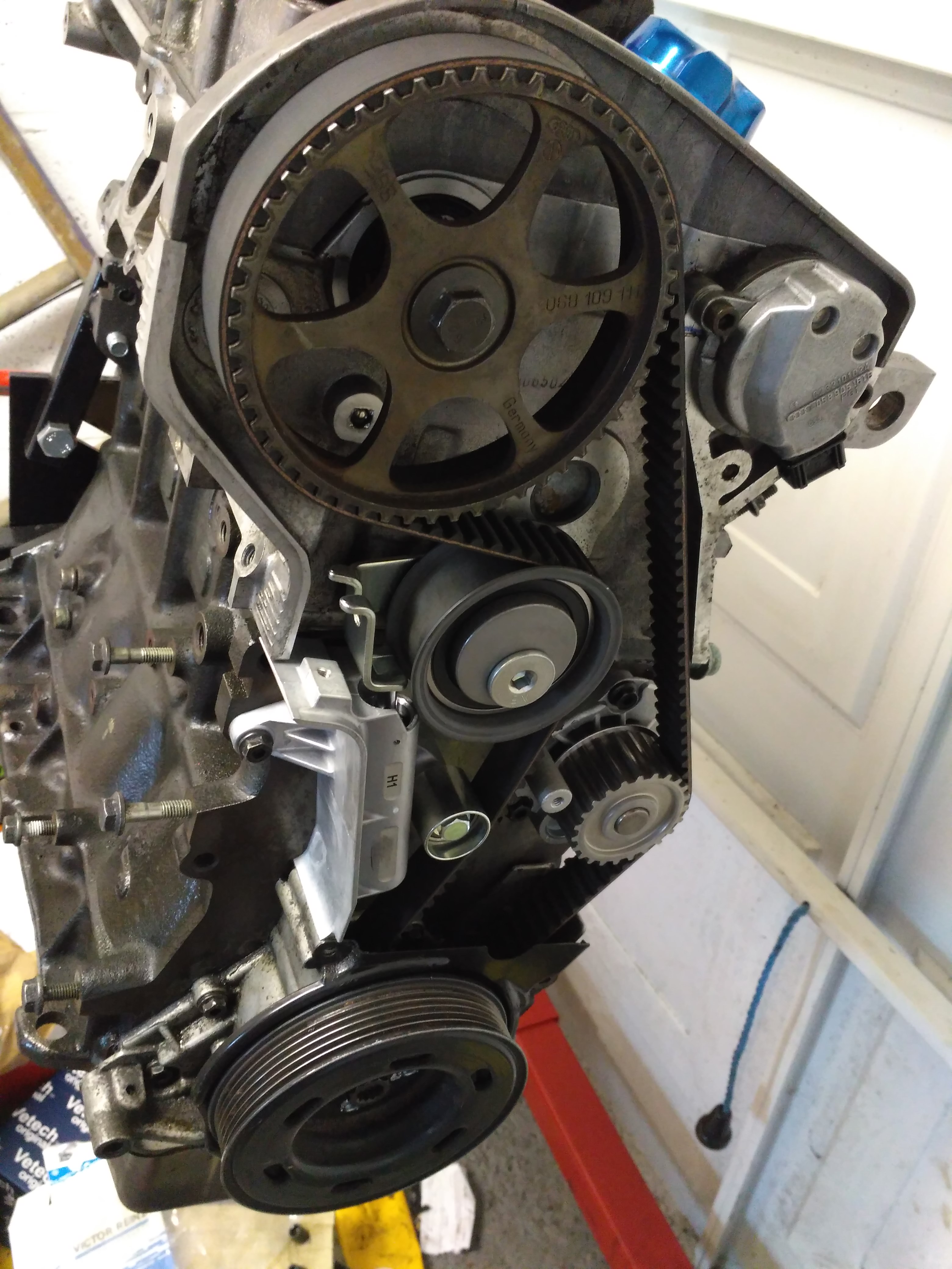

In related news: finally got around to timing up mine today.

@JolfaI could get my hair cut by my mum.
It has been done but it would be f**king terrible.
The Timing pulleys are not on a keyway and most garages have the cheap tools or no tools at all. The cheap tools bend when tightening up and throws your timing out.
I know youre going to argue so it's pretty pointless me even replying.

1 hour ago, Jolfa said:
If your mum was a hairdresser but just didn't specialise in styled men's fashion hair, but got it right regardless, what's the issue? Would you go and get it cut at a barbers to get it even righter or would that be a waste of money?
It's a toothed belt regardless, it's either a tooth (per pulley) out, or it's not, and if it's been done, and it's running fine, then it's not :huh:
Not quite mate. You can have it appear fine and the slack be taken up by the tensioner and appear right. I'm talking a few minutes out when tightening both pulleys and it throwing the timing out.
You're right in what you're saying about the toothed belt *if the pulleys were on a keyway* but they're not. They have to be lined up absolutely spot on prior to fitting the belt. Which is what most garages don't get. And they use tippex etc.

I think Dan means that by having no key the pulleys can easily be fitted with slight rotational misalignment, so actually rather than being it by discrete amounts (a tooth or so) it'd be possible to be out by any given amount (1°, 3.864° etc). The decent tools will hold things in the correct place better and reduce this risk.

18 minutes ago, CurtisRider said:
Forgive my ignorance...why does the pulley need to come off in the first place?
The dephaser is apart of this pulley. This controls the VVT and is replaced during this stage usually. I think it has to come off for another reason too though, maybe something is constrained for access to it.
  • Like 1
27 minutes ago, Danny said:
And if its been done wrong, and theres no keyway etc etc, how does someone who knows what they are doing correct lt? Dial gauges and measuring?
Have had to do it once before, dial gauge off one of the cam lobes usually.
3 hours ago, Jolfa said:
I see. Still though, if it's done and it's right, why do it again?
If timing is out, it's pretty bloody obvious, it'd feel like shit :P
It's actually really not that obvious. They idle lumpy as f**k standard so it's hard to tell but if it's done badly you're 20-30bhp down.
