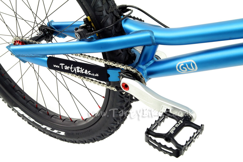

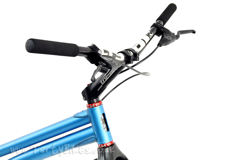

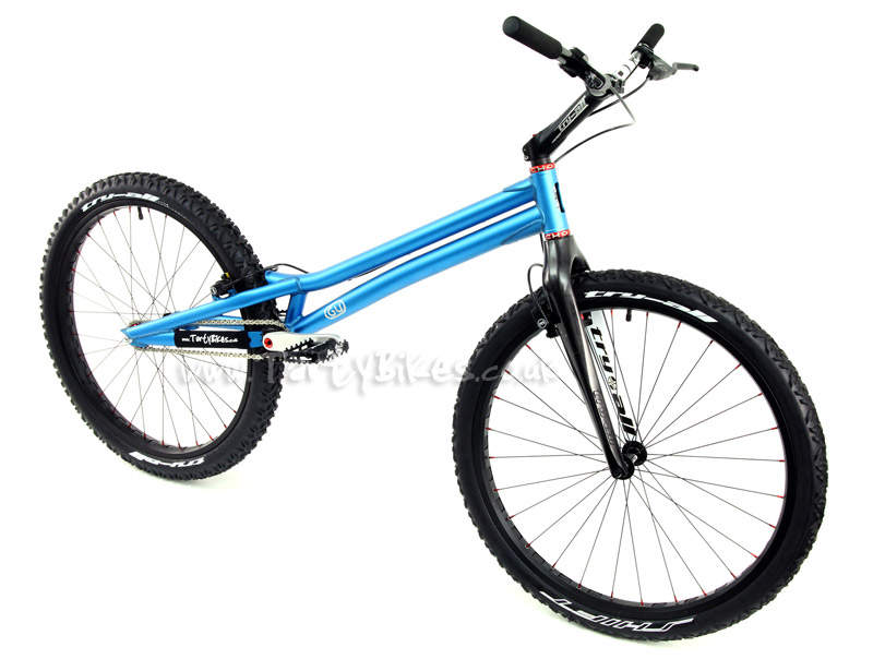

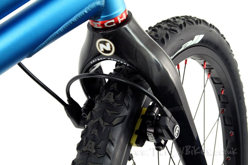

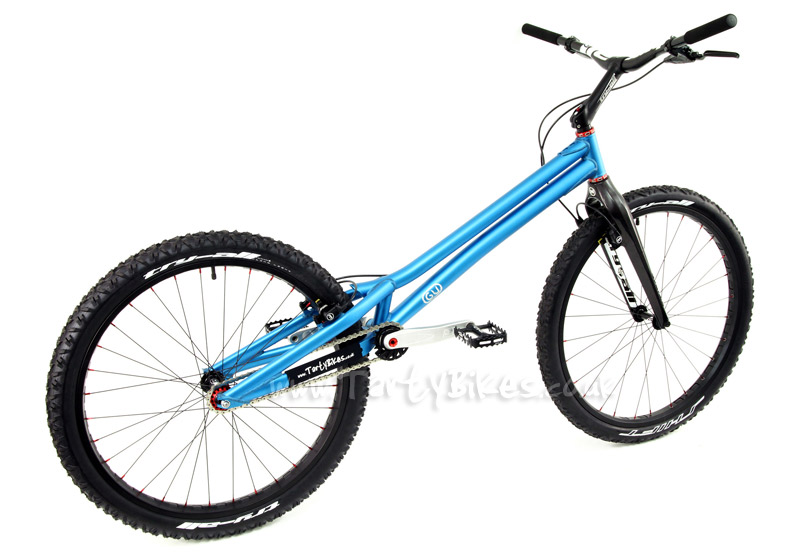

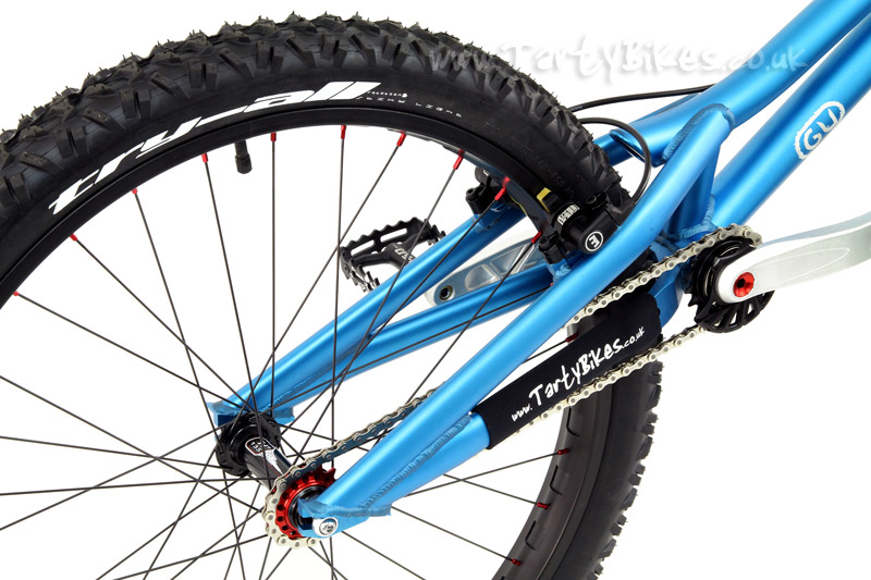

We haven't really posted any of the custom builds we've done for a while, but this one looks pretty sweet:
Frame and Fork
- Frame: GU 26" 2013
- Fork: Try-All Karbon, with TNN Karbon Steerer Insert
Wheels
- Front hub: Try-All 'H'100 Non Disc
- Rear hub: Try-All 'H'135 Non Disc
- Chain tensioner: GU Integrated Tensioners
- Front rim: Try-All Sky Front Rim, 28h
- Rear rim: Trialtech Sport Lite Rim, 32h
- Spokes: Triple butted front, double butted rear
- Rim tape: Try-All, Black
- Inner tube (front): Kenda
- Inner tube (rear): Kenda
- Front tyre: Try-All Shift 26 x 2.0"
- Rear tyre: Try-All Stiky Lite 26 x 2.5"
Brakes
- Front brake: Magura HS33 2011 (Long lever blade)
- Rear brake: Magura HS33 2011 (Long lever blade)
- Brake clamps: Try-All
- Brake Pads: Koxx Yellow Croco
Drivetrain
- Cranks: Try-All CNC ISIS, 175mm
- Freewheel: Try-All 108.9, 18t
- Chain: KMC Z610HX
- Rear Sprocket: Try-All Aluminium Screw-On 15t
- Pedals: Try-All Single Cage
- Bottom bracket: Echo Urban ISIS Titanium
- Bottom bracket bolts: Echo SL Alloy
- Bashring: Try-All Symetrik, Black
Steering
- Headset: Echo SL, Red
- Stem: Try-All 3D Forged, 150mm x 30°
- Grips: Try-All Foam
- Handlebars: Try-All Carbon
Weight
- 8.24kg including pedals.
Geometry
Wheelbase: 1095mm
Chainstay Length: 380mm (18:15 gear ratio with no half link)
BB Rise: 70mm
Head Angle: 71 degrees
Centre of BB shell to top centre of head tube: 660mm

Haha, what? We all really liked the colour scheme which is why we specifically chose that frame colour for it, and added stuff like the coloured crank bolts and headset. Also, the vast majority of people (i.e. everyone in this thread but you, people on other forums where it's been posted, our Facebook page) all seem to really like it and how it looks.
