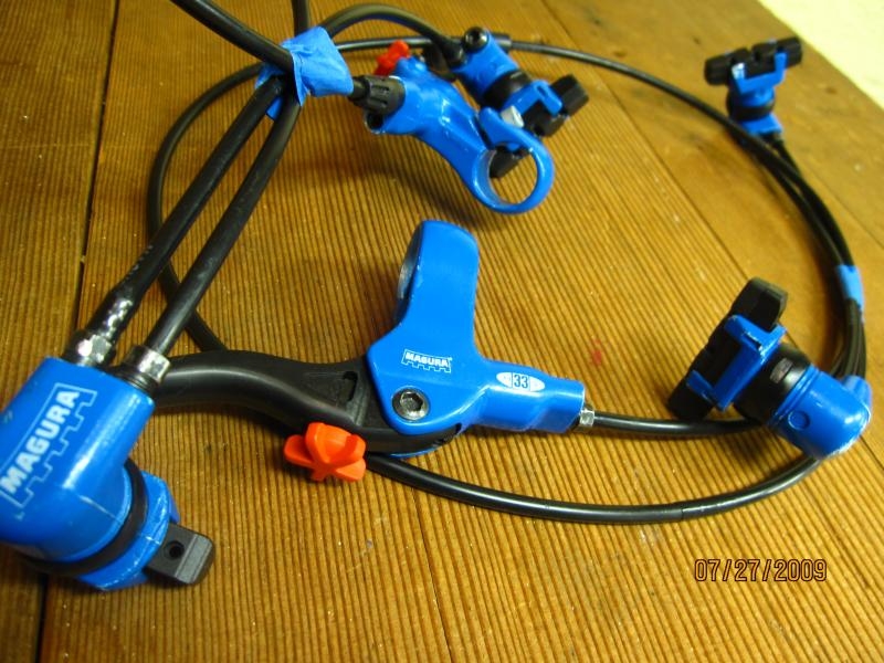

The classic '04 Magura!

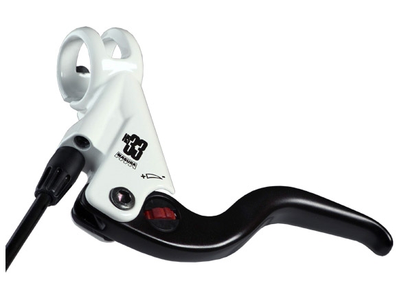

The much imitated '05 Magura!

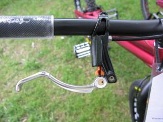

Cast Echo Lever body

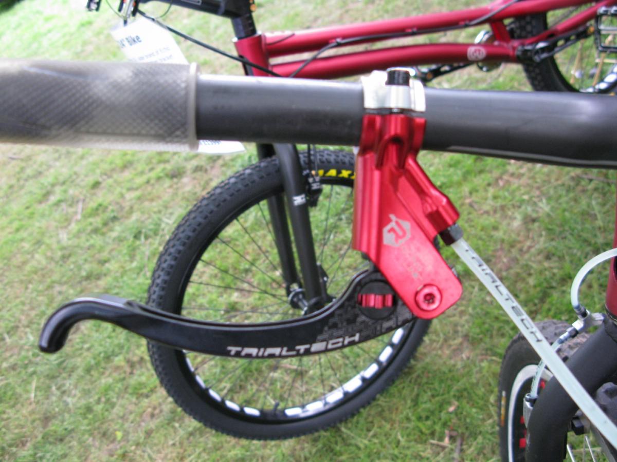

Racing Line lever body + Trialtech lever

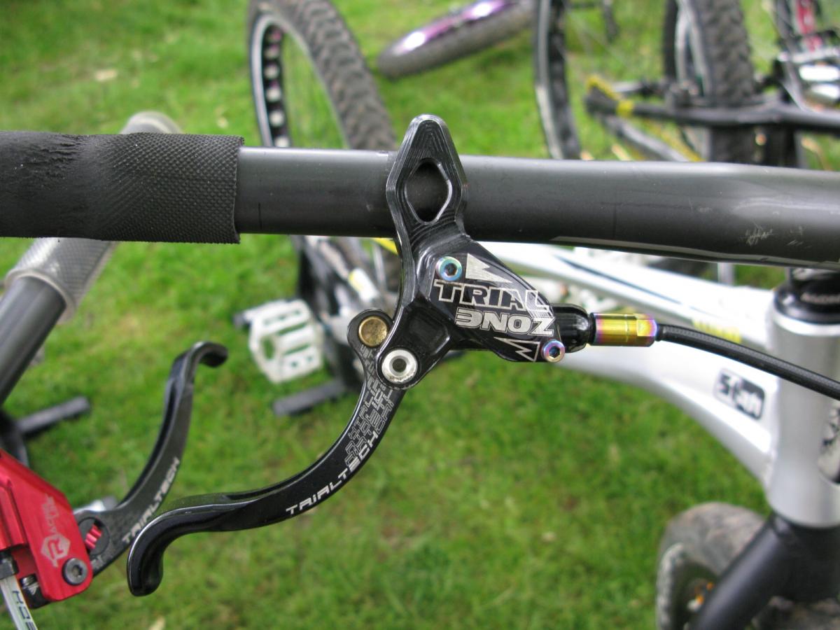

Hope Trial Zone lever (Disc) for inspiration!
