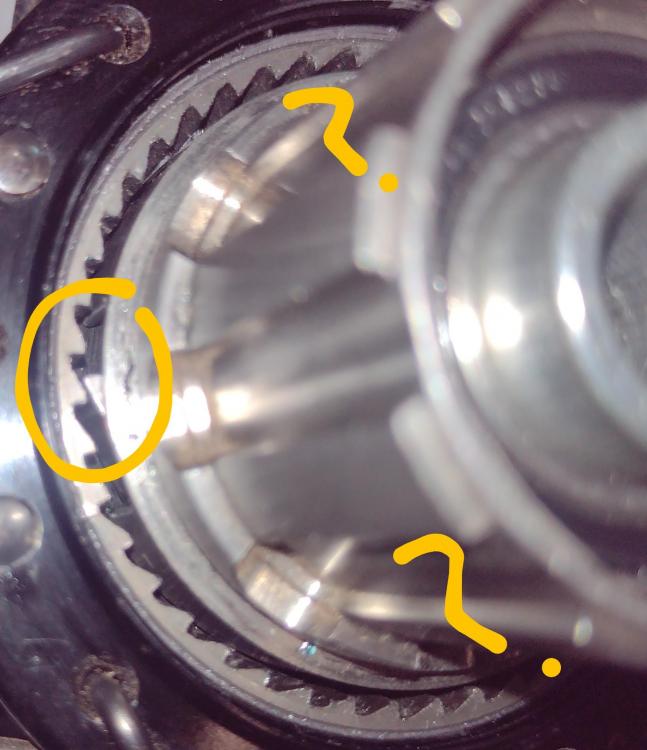

Firstly i was having a few skips and weird clicks under low force usually like turning etc I took it apart and pawls and lockring teeth were worn / damaged/ chipped  the hub was not very old and Hope replaced the lockring and pawls on warranty
Then that same lockring stripped out the hub about a 3 or 4 rides later it happened when I was putting full power down back it went and they provided a new hubshell with "extra locktite"

Interesting, I had the same issue on my Industry Nine Hydra hub. Skipping only under very light pedal pressure. Pawl seats were very worn out after a few months, and teeth in the ring were ever so slightly damaged. Industry Nine sent me a new hub straight away (great service, and I'm in Europe too), which I've just built into a new wheel. And lo and behold, the new hub also does the skipping. Second ride in, first skip. Not as bad yet as the old one and there appears to be no damage on the teeth yet. Is this something inherent to trials use with these pawl type hubs? I have to say I had no problems with my old Hope Evo hub.
My i9 had some relatively thick grease in it to begin with - if you still have that grease in yours it may not be helping with some of those smaller skips. I've never noticed mine skipping, and I don't think any of the Inspired team riders using them have reported anything about that either.

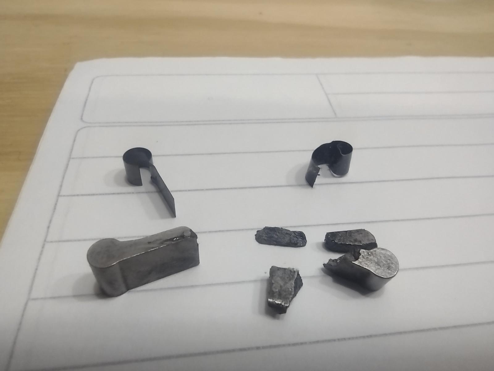

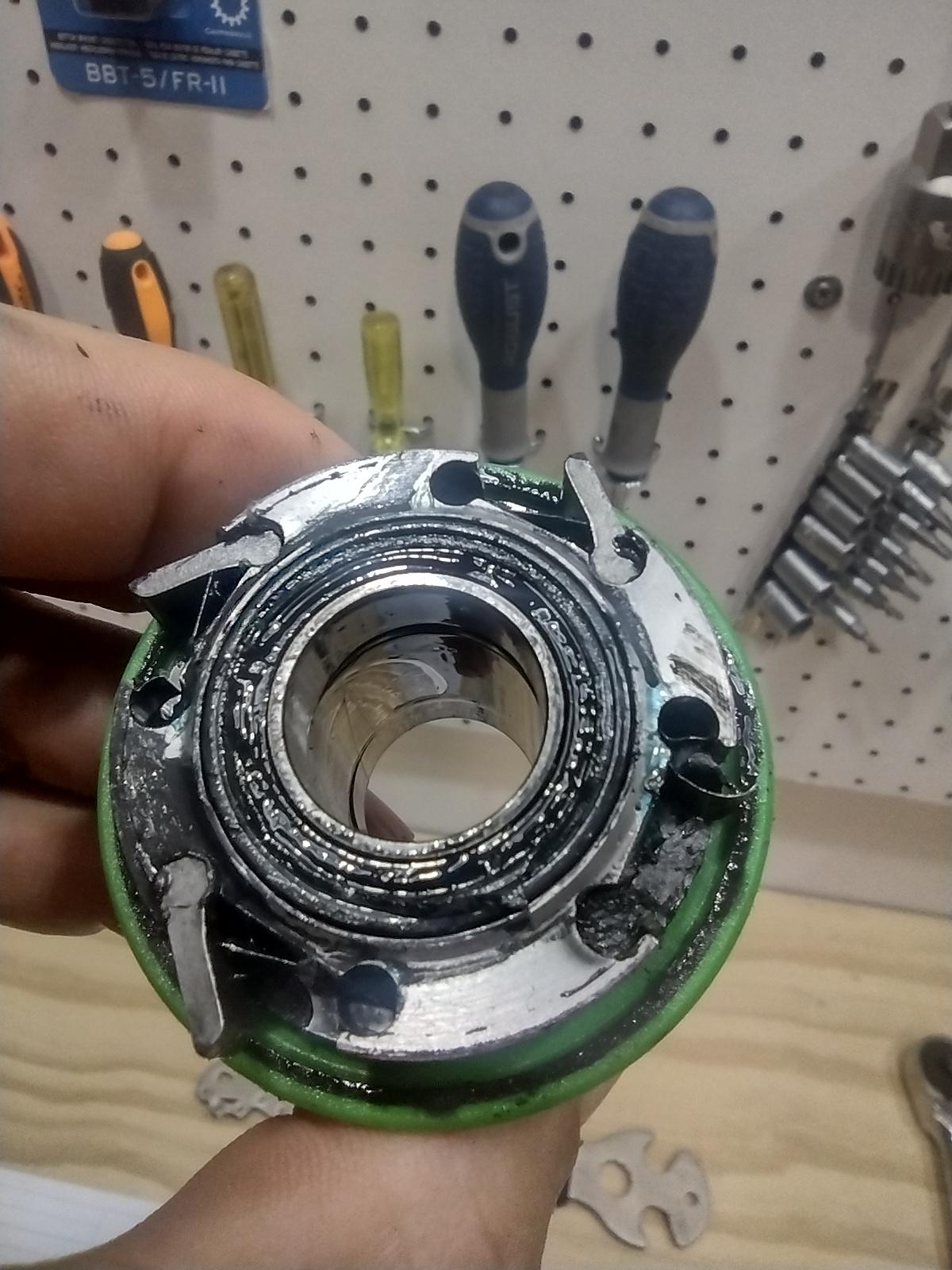

Late, but speaking abot the Hope Pro 4 SS, I broke a pawl last week (this hub 1,5 years/1 hour a day of riding on average).  the hub has 4 pawls and should engage 2 at a time as it works offset.  but when you spin the body, 2 of them do not always engage, many times only one works to support all the power.  one tip was to use double spring... I bought several sets of pawls/springs to try (before change the brand...).
