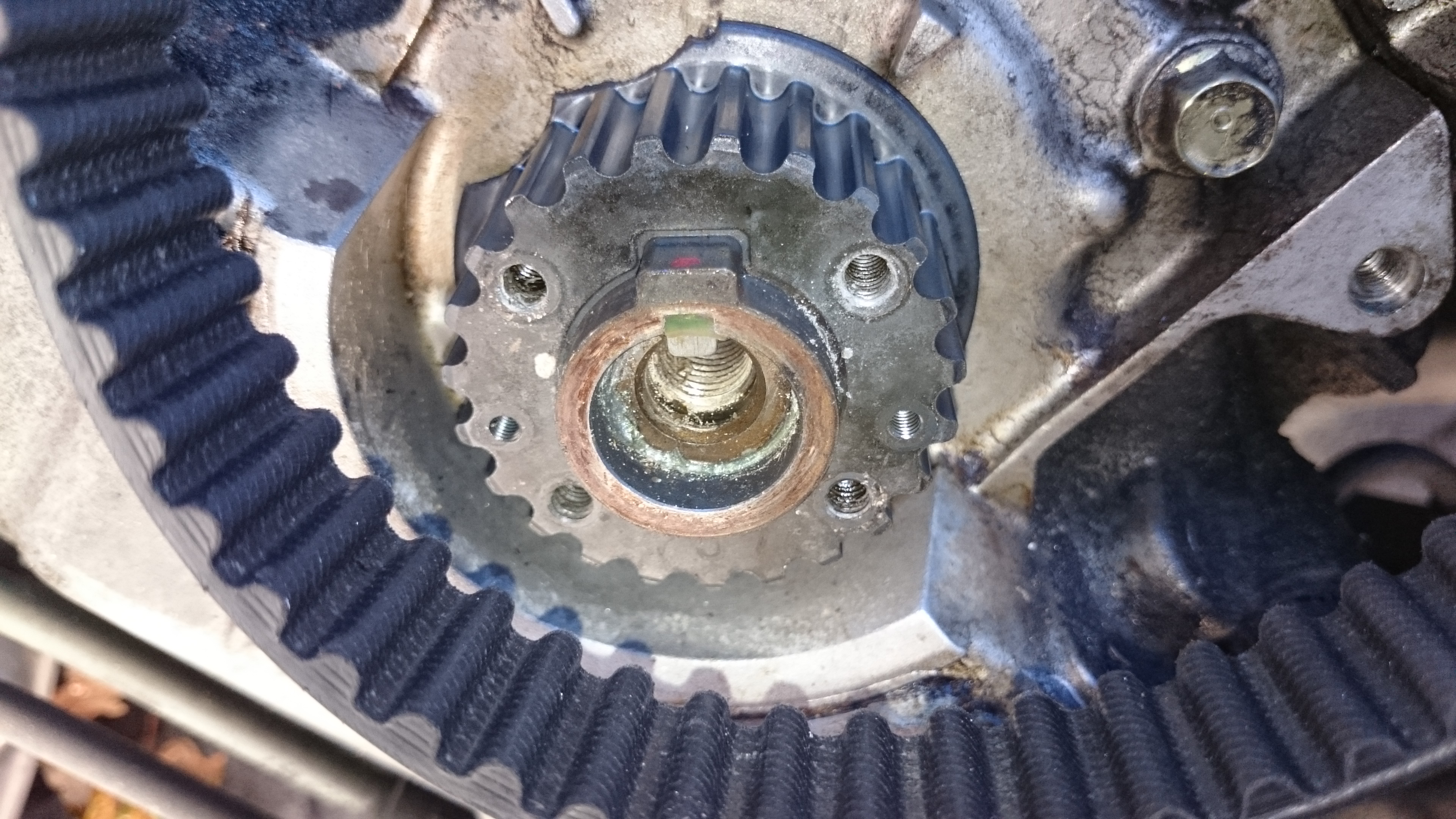

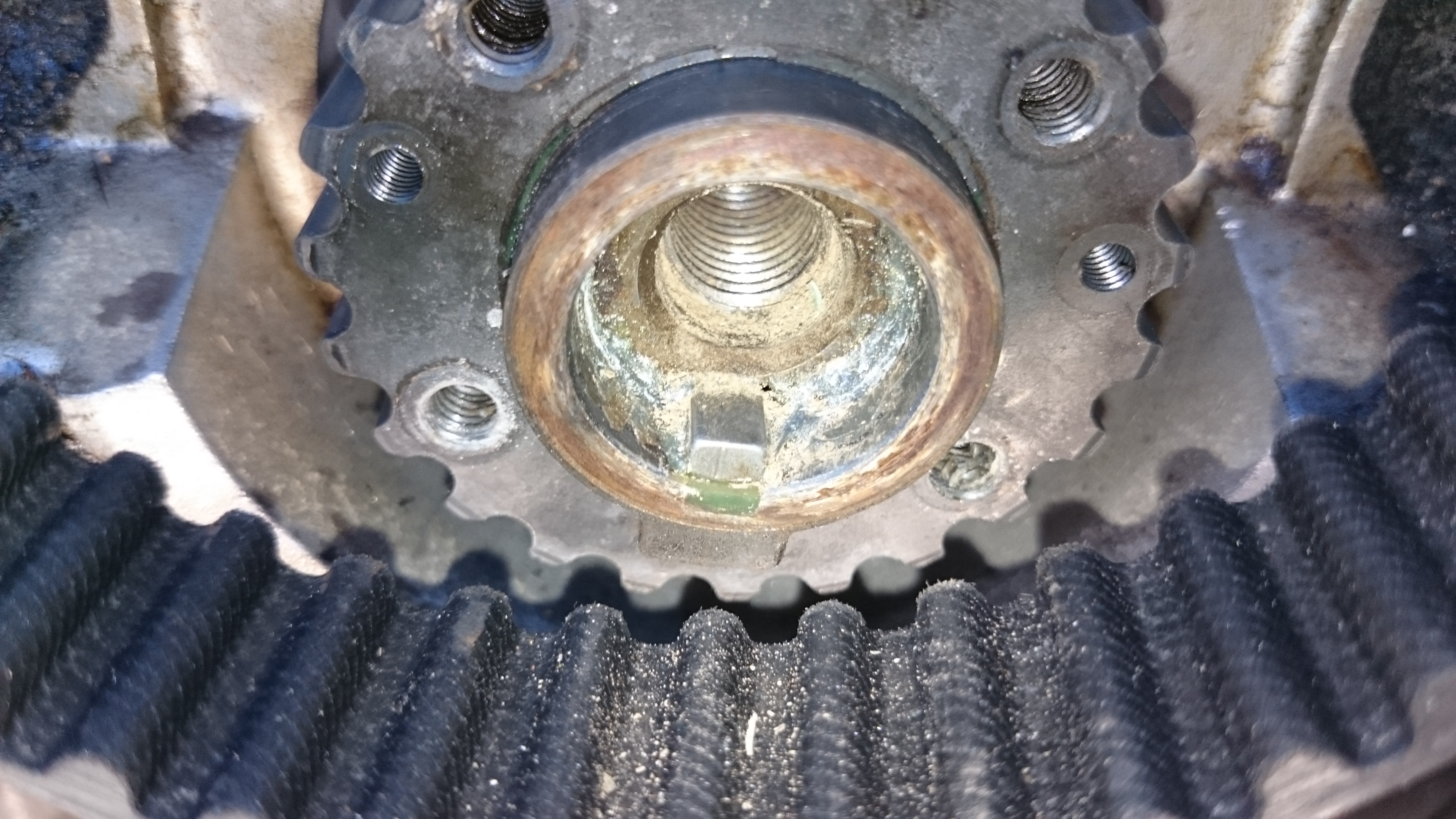

Took the crank pulley off the mx5 to track down the wobble. It looks like someone has been here before, though I can't tell exactly what they've used to bond/weld the gear to the crank.
I couldn't get a puller behind the gear to confirm that the 'fix' was still solid, so I just put it all back together. (the cracked backing on the gear wasn't me) I'm kinda hoping that the slight wobble is due to the gear not being perfectly straight. I'll just run it, it may have been like this for years.
I would say that the gunk is just dried loctite.  Easy to get the pulley off though, get a steel plate with two holes in to suit the diametrically opposite tapped holes, chuck a spacer into the pulley (a socket will do) and use a couple of set pins  in the threaded holes to draw the pulley off the shaft; as it comes off, add washers between the spacer and the plate to take up the slack.  If it were wobbling on a worn keyway / shaft / pulley I would expect it to be able to be pulled off by hand.
  • Like 1
It looks pretty solid - the pulley itself might wobble a bit as it's rubber mounted, that's fine.
The main thing to check is the keyway in the crank nose itself, as long as the key is tight into the slot and there's no evidence of flaring / cracking, it's fine.

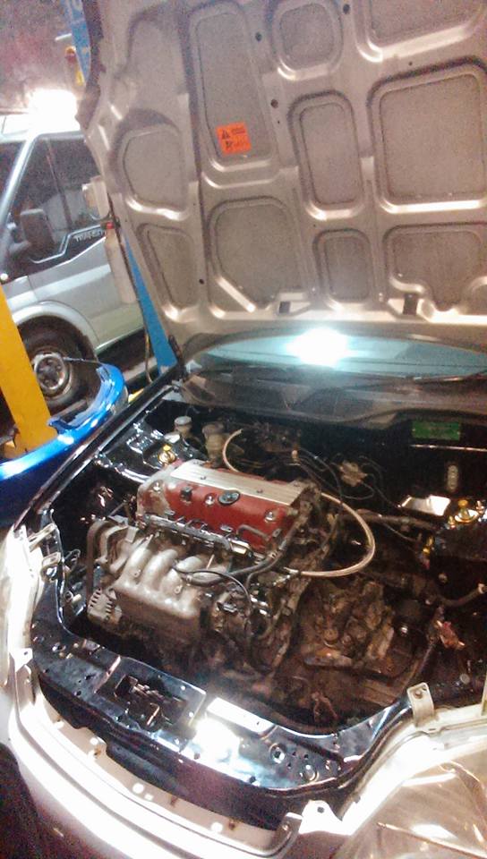

Another piss poor photo..
We're getting there. I got given a Tegiwa S2000 alloy radiator with the engine back in October so Ive been looking at how it could work out.
I think I can make it happen. The upper outlet meets the OEM K series hose perfectly, but the lower one is on the wrong side. A cut B series lower hose would do the job perfectly, BUT I think I'll be taking it across to the fabricators tomorrow and asking them to re-weld the outlet on the correct side and allow me to use the OEM K series lower rad hose too. Ive aimed for this build to be as OEM as I can to retain its Honda reliability. Got a clutch line made up (barely visable) using the original clutch line flexi pipe. Flexi out of the brakcet, flipped round the opposite way so it aims towards the gearbox side, new pipe from clutch master cylinder to flexi, new pipe from flexi to slave cylinder.
The induction set up is made up of an AEM coupling, a butchered B series AEM long arm (given to me for nothing with the car, and already cut), the OEM rubber intake pipe and an old filter I had from my B swap. Fits nicely, serves a purpose and cost f**k all!
IT MOVED UNDER ITS OWN POWER FOR THE FIRST TIME TONIGHT :D
