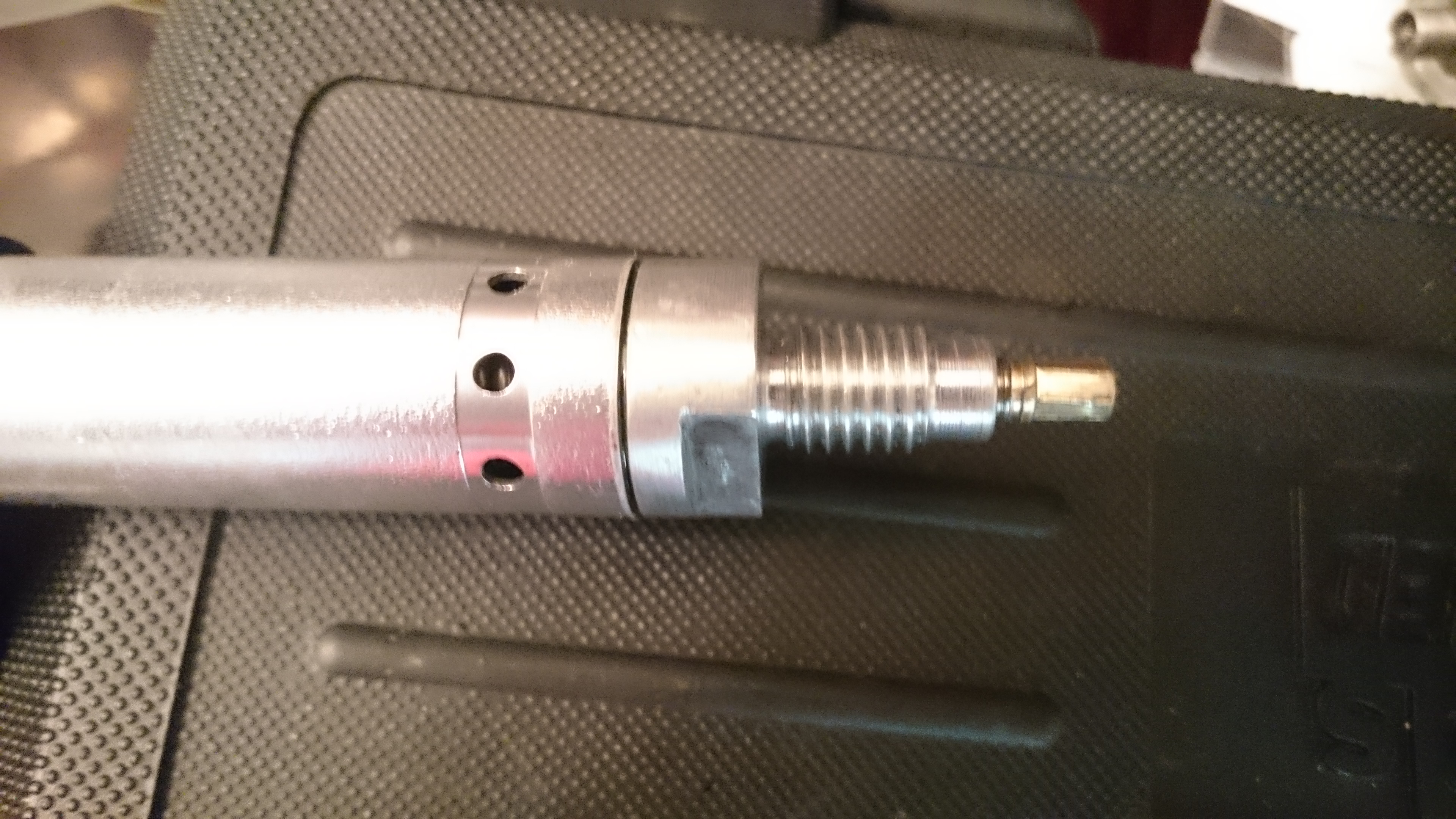

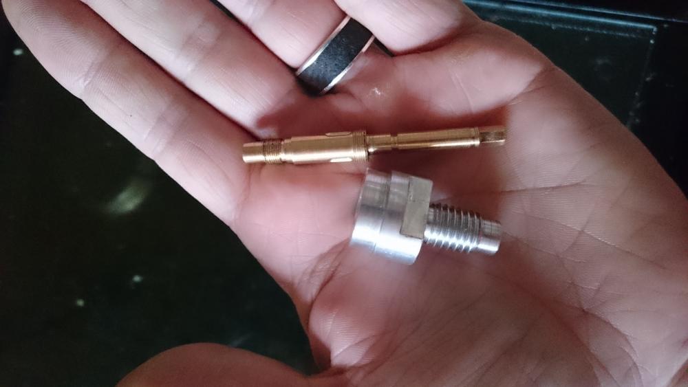

edit: look what arrived this morning!

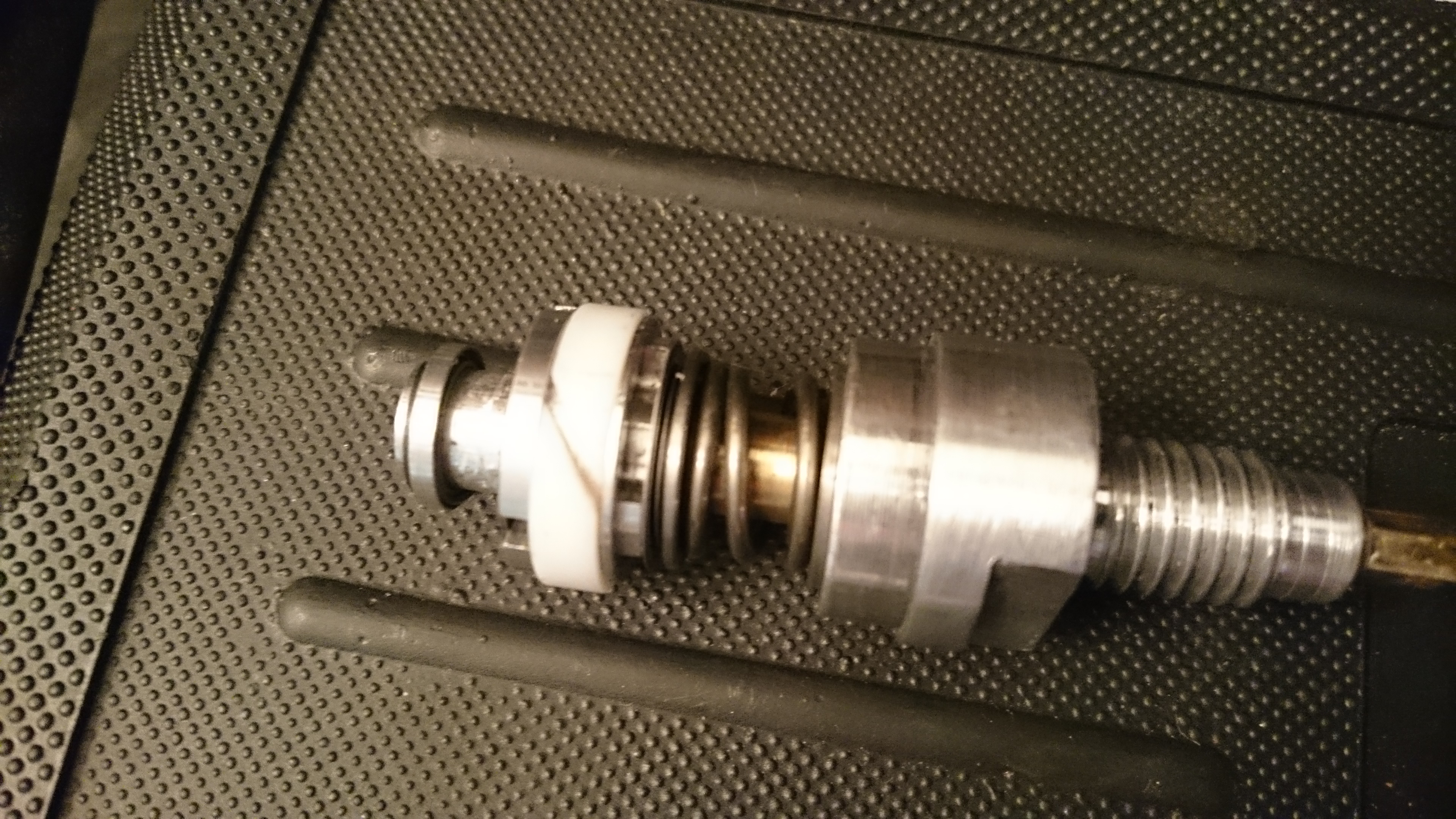

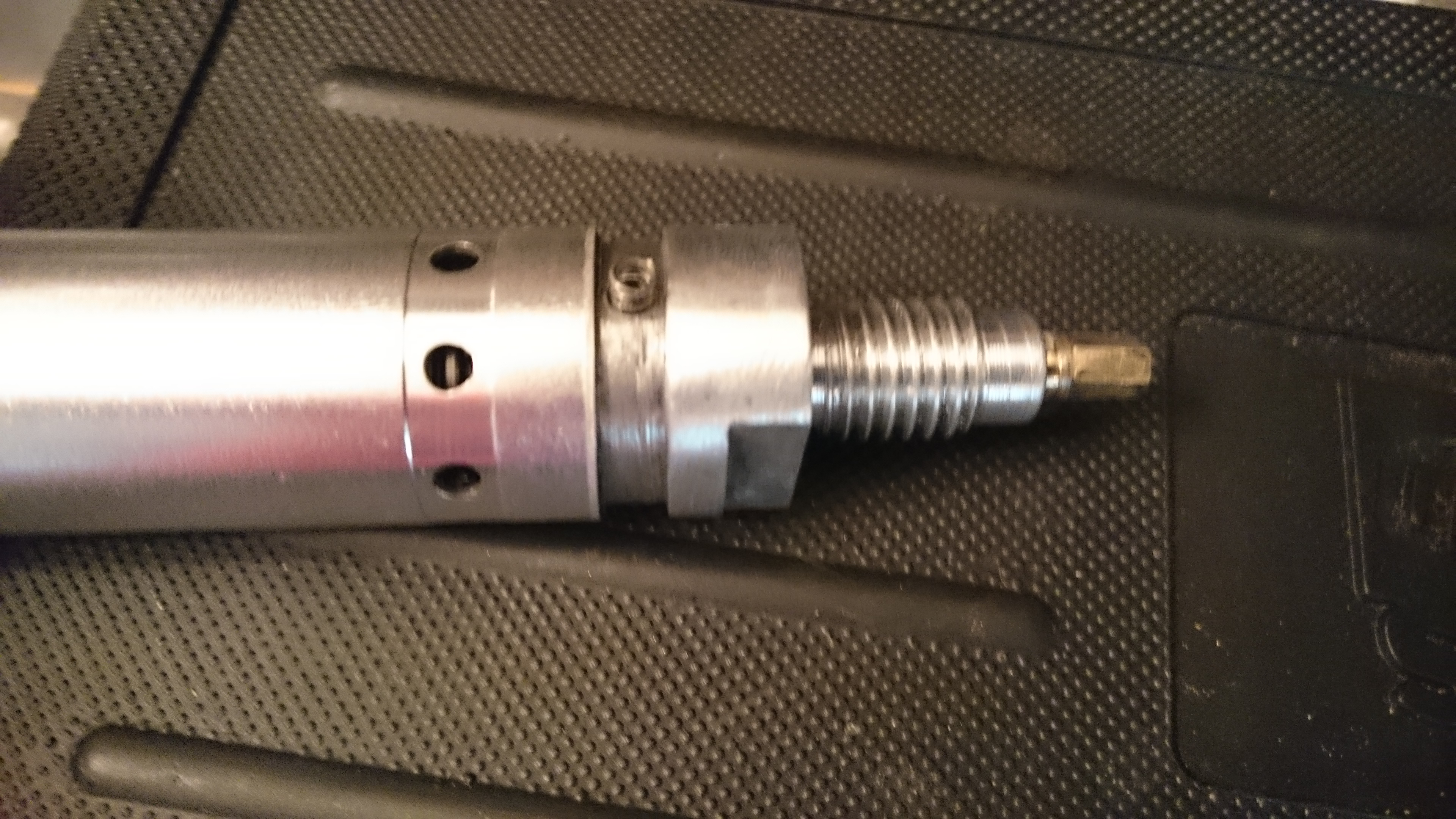

Updated cartridge is now assembled, ready to put back into the chassis :)
Guessed at the shim stack, trying a simple crossover with 15-14-8-12-11-10-8 diameter shims, all 0.15mm thick apart from the 8mm ones at 0.2mm thick.
Left it with the shim stack controlling both high and low speed compression, only riding it will tell me if it's crap or not. Not a massive issue to alter the stack now though.
Super happy with how it's gone together :D
