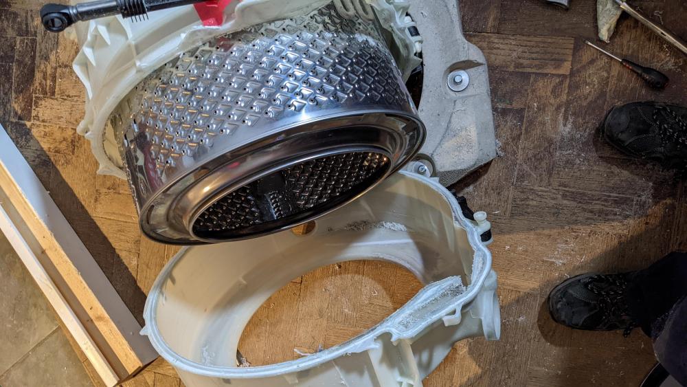

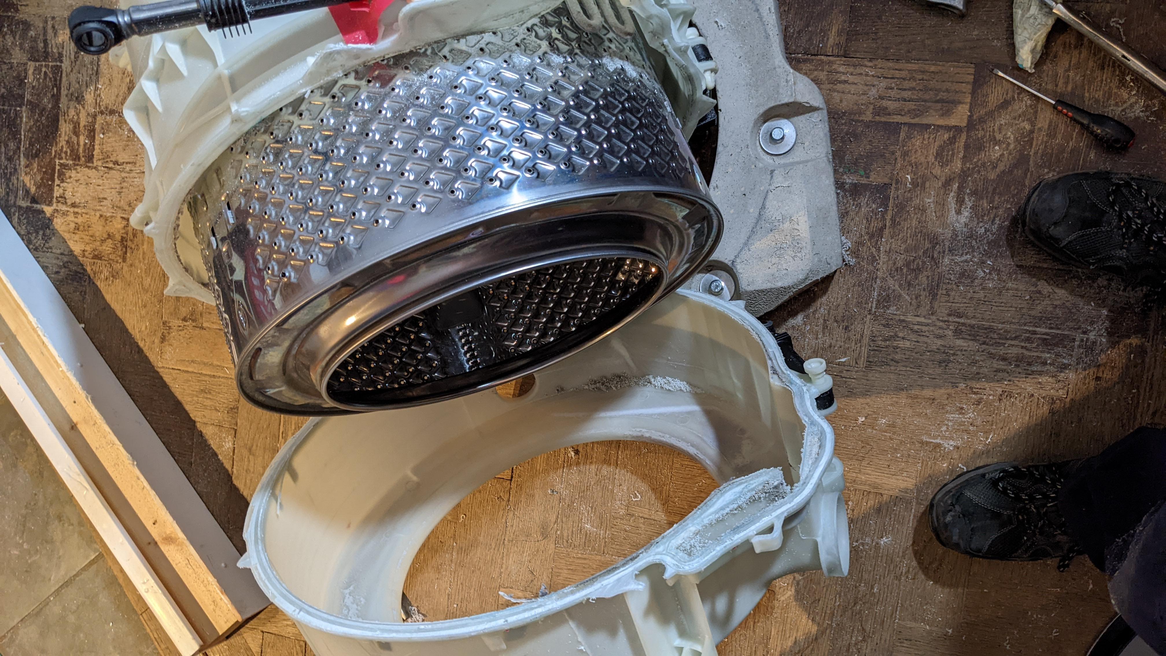

So the washing machine has been getting noisy on the spin cycle of late, seal has obviously failed and washed the grease out of the inner bearing. Outer bearing is perfect and the drum is rock solid with no movement so now is the ideal time to pop new bearings in. It's 7-8 years old and has been washing nappies all of its life so to be fair it's done incredibly well.
Except f**k you beko, what tosser though it was a good idea to weld the two halves of the plastic outer drum together so you cannot get the inner drum out to replace bearings. 140 quid for an entire drum assembly and throw the entire thing away....
Bollocks to that, the machine might go pop next week so we're not going to spend 140 quid on a new drum.

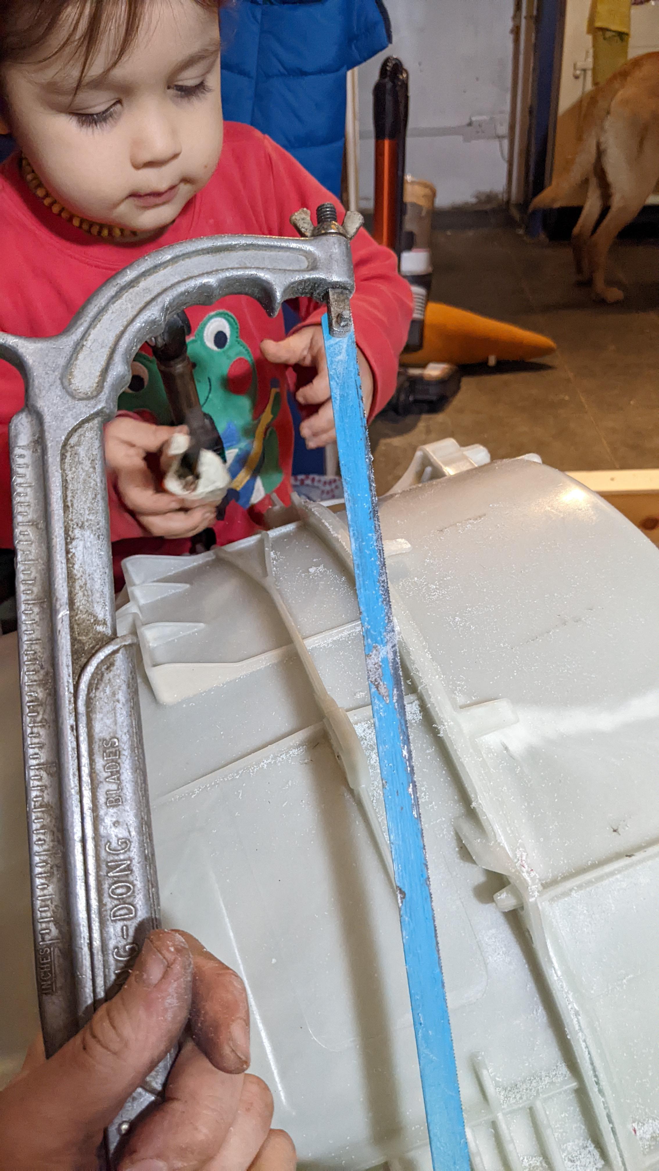

Enter Mr hacksaw, after 3 hours of sawing I now have the inner drum out, ready to get new seal and bearings tomorrow.
What a bloody ridiculous design, it appears to be rife with most of the manufacturers now :(
Aneurin helped me with a spare hacksaw blade converted into a padsaw with some cardboard and masking tape for a handle :D
Edited by forteh
I found this out recently while looking for a washing machine and dryer. There's a UK company called EBac that are trying to resolve this issue by selling all the spare parts to their machines. The problem is they are shite and what I've read the delivery company (DX) are a huge part of the problem.
This is just another case of manufactures building in obsolescence so you have to buy a new one every few years. I personally think this is a big issue that should be sorted to save the environment.
Yeah I've heard the name ebac but not looked into them, it would appear that only a few companies still split the drum to allow bearing replacement.
Pulled the old bearings and seal out this morning, went and got replacements from the local engineering supply and set about cleaning the drum up before putting them back in.
A YouTube video had suggested using gorilla glue to stick the two halves back together but this one is polypropylene so all but impossible to glue. Bolted the cut flange back together with about 20 M5 screws and nylocks and then welded the joint shut with an old soldering iron. Tested it with a couple of gallon of water as a drip test and all seems to be water tight.
Just finished putting it back together and run a rinse and spin cycle though and all sweet as a nut and back to being virtually silent again :)
Total cost, just over 35 quid.
How long it lasts is anyone's guess :D
I think it'll be ok as long as there isn't a massive out of balance load. The concrete balance weights are attached to the front and back sections of the drum hence if there's loads of movement then it'll be stressing the weld rather a lot. Time will tell.
